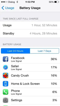

I want to know why my battery drains out quickly when compared to other iPhones 5S?? Is it a problem with my phone??
Will a full restore can help me or what should I do for this
Please consider the screenshot below
Thanx in advance please help me fix this
I have already Switched off Location service and background app refresh and Motion and the brightness is also manually adjusted to a lower level to my vision
Thax pls help me

From your screenshot you are currently using your iPhone in a low signal area. In fact, at the time you made the screenshot your iPhone was on Edge, which is even slower than 2g. Your phone will be continuously searching for a better signal, adding to the battery drain. Your FaceBook, Safari, and Phone apps all show low signal. FaceBook is also a known battery hog and the low signal strength will only make it worse.
If possible, test your iPhone in an area with better signal strength and see if it makes a difference. Try to get at least strong 3G signal and you will get a much better idea of how long your battery will last in normal use.

If the problem is caused by low signal strength in the area, restoring the phone won't help. You could try resetting all settings to see if that helps. To do so, go to Settings>General>Reset>Reset All Settings. You won't lose any data by doing this but you will have to re-enter your password in sites that normally remember you.
