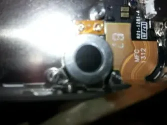

I am having a hard time unscrewing the screw located on the side of my iphone. Anyone who has a cdma iphobe may know which one im talking about. It is blocked by an object in the phone and i was wondering if anyone had an easier way of unscrewing it

Its to the left of that donut looking thing with the black middle
That doughnut looking thingy, that would be your vibrator, and it is held to the midframe with some double sided sticky tape. Use something to pry it up, but be gentle. This will expose that side screw that you are trying to access. Another word of advice, DON'T FULLY REMOVE THE SIDE SCREWS!!!! They are a pain in the a** to get back on, and they just need to be loosened to about two full turns. Just some words of advice hope I was able to help you. Any questions feel free to ask.
