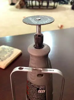

I use the spigen neo hybrid ex(very nice bumper). For the lightning to 30pin WITH cord(.2m) i had to cut the case down with a dremel. For some reason apple didnt make the lightning to 30pin the same size as the regular charger....
2 cuts and done. if anyone is interested in seeing how i did it ill post pics. might help with other cases as well.
Tool and the 2 cuts.
The dremel tool was thick enough to only need the 2 cuts. nice and easy.
The top part didnt need to be cut, it fit.
