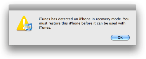

Now need to put phone into dfu mode with itune's.
To do this Step One
Open iTunes and connect the iPhone to your pc/mac
Step Two
Press and hold the Home button and the Sleep/Wake button at the same time
Step Three
After exactly 10 seconds release the Sleep/Wake button. Continue holding the home button until you iTunes pops up a message telling you that it has detected an iPhone in recovery mode.
(((The iPhone screen will remain black like this)))
Next Hold down shift key and find the custom ios just downloaded and hit restore.
You may get two error code's 1st one is normal second error code is due to its custom ios to fix this just use tiny.
Ok when resorting it may crash just unplug the usb and put it back in hit ok on the error.
