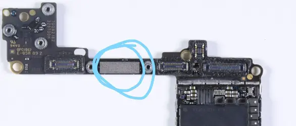

I've dropped my iphone 7 into the water and its overheating now. But only one module. You can see it on the picrute. Its the grey little thing. Can somebody help me what that is ? maybe a possible fix ?

That component Is the M2600 flash module. Is the flash currently working?

Big thanks !!!! I didn't even notice it. No it's not working. But overheating stopped and mobile is working normally. Only without flash and rear camera.
