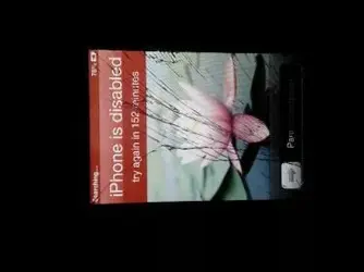

I have a phone that onky turns on when plugged into a wall charger. When it does boot up there is a passcode lock on it. After a few minutes it reboots. Im t
hinking the reboot is due to a bad battery?
You need a new battery and/or a check that the all the battery related components are in place. Assuming this is a regular issue, replacing the battery will help as well as putting in the correct passcode if you don't want to DFU restore the device
