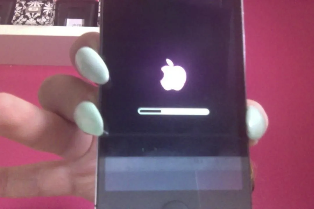

my iphone4 suddenly closed and will not open.. and when i try to restore the bar gets stuck like the picture i uploaded shows !!
any ideas?
please help as soon as possible!!!
is there a way i can fix is or should i through it in the garbage for good please help me

Follow this guide here. Assuming it's just a hiccup, that should fix it. Otherwise, we'll have to find alternatives to find out the solution before we opt for a paperweight.
i read the post but i couldnt find what you are recommending for me ... can you give a snapshot or something because i got lost in allthose information
To put it simple, put the device into DFU mode or Recovery Mode, and restore. Just hold the power/sleep and home button together until the screen turns black and release both to turn the device off. To put it into Recovery Mode, hold the home button and keep holding it while you plug your phone in and let the device boot up.
