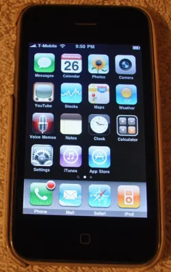

  1. This morning, I downgraded iOS 4.2.1 to iOS 3.1.3 using iTunes, iClarify, & Tiny Umbrella (in order to get out of iTunes restore mode)
  2. But then, the iPhone 3G had no sea-of-icons home screen, and could only make emergency calls on T-Mobile
  3. My next step was to activate (either with an active or inactive AT&T SIM card or using Hacktivate (with Redsn0w & SAM)
    • Note: Luckily, I didn't need Redsn0w because my 3-month old inactive AT&T SIM card worked great with iTunes to activate the iPhone 3G.
    • That finally got me the iPod-like sea-of-icons home screen! (THANKS!)

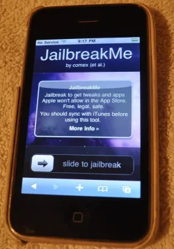

Apparently, now that I'm on iOS 3.1.3, I had these options for jailbreaking:
a) Spirit (download it to the PC, tether the iPhone, and hit 1 button to jailbreak)
b) Redsn0w
c) Jailbreakme.com (connect to wifi, go to [URL="http://www.jailbreakme.com"]JailbreakMe 3.0[/URL] in Safari, follow instructions to jailbreak)
Here is what I did:
1. In a prior post, I finally got out of iTunes recovery mode by using Tiny Umbrella, iTunes, and iClarify ipsw files for the iPhone 3G iOS 3.1.3 (all the data was lost in that process)
2. In a prior post, I activated the iPhone by tethering to iTunes & using my 3-month-old inactive AT&T card
3. Now, with the T-Mobile SIM card in the still-locked iPhone ... I set up the WiFi encryption for my home network (I don't have the T-Mobile data plan ... which is the whole reason for switching off of AT&T)

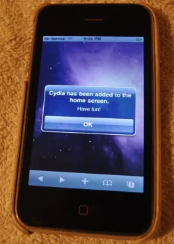

4. And then simply went to Jailbreakme.com in Safari & moved the slider to begin the process
- I eventually saw the message "Cydia has been added to the home screen" (so that solves the question of how to get Cydia on board)

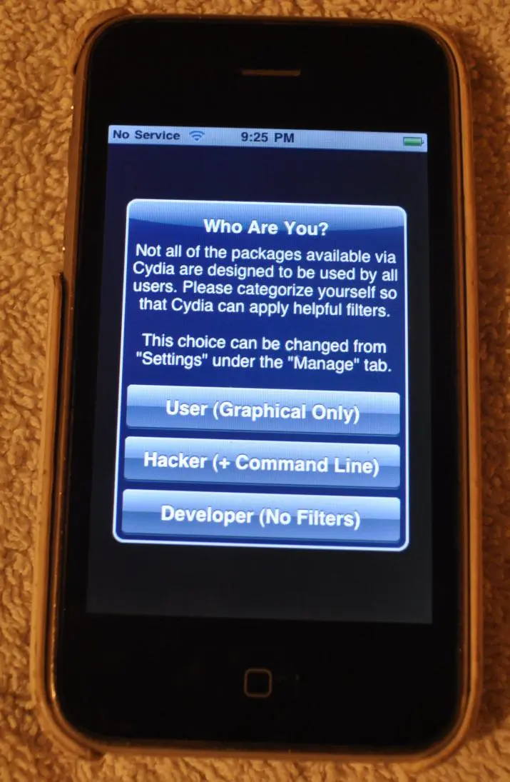

5. I started Cydia ...
- It asked "Who Are You?" (I said "Hacker" although that was being generous)
- Cydia started downloading packages & reloading data.

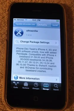

6. I clicked on the open-book icon for "Manage" at the bottom of the Cydia screen
- Then I hit the "Sources" button in the center of the screen.
- Then I hit "repo666.ultrasn0w.com" & then "ultrasn0w" (which only then revealed itself to be version 1.2.4)
- I hit the "install" and "confirm" buttons & it installed & reloaded data.
- I had to hit the home button to "Reaload Springboard"

To help others, here are some related pictures.
[ATTACH=CONFIG]2921[/ATTACH][ATTACH=CONFIG]2922[/ATTACH][ATTACH=CONFIG]2923[/ATTACH][ATTACH=CONFIG]2924[/ATTACH][ATTACH=CONFIG]2925[/ATTACH][ATTACH=CONFIG]2922[/ATTACH]
