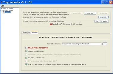

I have downloaded v5.11.01.
I checked the option "Request SHSH from Cydia"
but the "Save SHSH" option is grayed out.
Okay - re-started everything and now it's recognizing the phone - I think (shows Recovery Devices, then 1114129 as the device). And I can click on Save SHSH, but nothing happens.
like this:
it would just do that every time I plugged it in to the computer : /
