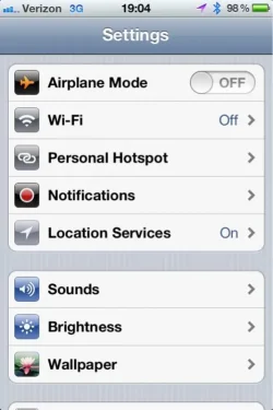

I don't know about your network and stuff but on my phone it added a personal hotspot menu on the settings page.
I just open that and my iPad finds the wifi.
