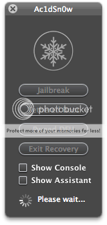

1. Launch the ac1dsn0w application and you will be presented with a screen as follows:
Note for n00bs: Ac1dsn0w seems to have been developed primarily for seasoned jail breakers that are familiar with the process of jailbreaking Apple devices. The basic assumption is that you know how to get your device into DFU mode. If you press ANY of the 4 primary buttons for Jailbreak, Tethered Boot, Pwned DFU, or Exit Recovery, the tool assumes you have ALREADY put your device into DFU mode. Don't worry if you don't understand this. ac1dsn0w can still help you out too!
