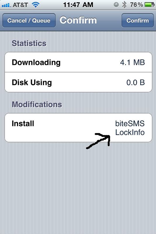

Is this what you mean by stuck in cache?
Replace locinfo with mobile terminal.
If so I can walk you through how to get it out of your queued download list.
I for instance had lockinfo stuck and would not install anything from cydia without trying to install this as well. And would make it error out everytime.

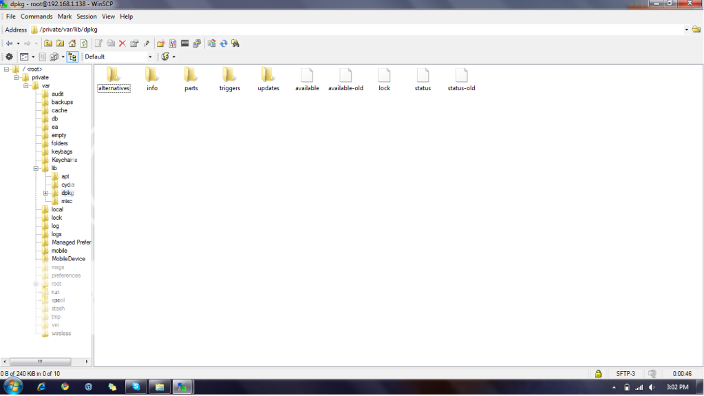

Ok , so the first step is you have to ssh into your phone. You go to var/lib/dpkg. You will see a series of files. What you are going to do is modify Available , Available-old.
Status and status-old. Please make back ups of these files before you start. You go into each of the files and ctrl+f and enter your offending queued whatever. In your case it's mobile terminal. You need to delete the entire package of all mobile terminal from all 4 files and save them. After this is done respring and your done. I can provide screenshpts of the whole process if you need me to. I am away from my home computer for now though. So.if you don't feel comfortable doing as I explained without pictures your gonna have to wait one more day. Lol ! It really is easy though. Lmk.

Ssh into your phone. I use Wincp. And you want to follow the path of var/lib/dpkg. This is the screen you want to reach.

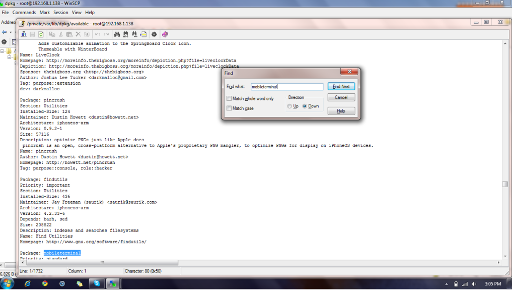

Go into Available, Available-old, Status, And Status-old Ctrl+f And enter your offending app(in this case it's Mobile Terminal).

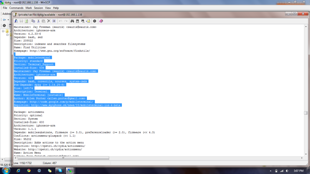

Highlight the entire package and simply hit back space. Notice that I am leaving a space between the exsisting packages.
Make sure to do this to all four aforementioned files . Save after each file is modified. Close everything down . Respring your phone and reload Cydia with a cleared Queue. Note, before any mods are done BACK UP the files. Gl . Hth !
