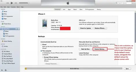

My nephew apparently backed up my sister's iPhone 5 to a USB via iTunes, and the USB now has 6.3+GB of data stored onto it. Somehow he couldn't get the data to be restored back on to the iPhone.
His story is that he called up Apple Support, and they told him to go to REGEDIT (yes, we are working off a Windows laptop, and we have access to a MacBook, if this will help). He was then told to type:
%something%
Yes, I know, not really helpful, but this is all he can remember... specifically the string beginning and ending with a percent sign. Apparently this showed all data available. He was then asked to open the found data in a Windows browser, and copy all the data this way to the USB. This is how he has acquired the data currently on the USB.
Due to not being able to resolve the dilemma this way, I was asked to help, as I know somewhat about computers... So I checked online for a solution, to no avail unfortunately. All "solutions" seemed to point towards using iTunes to restore any backed up data.
I also tried restoring the data via iTunes, also to no avail.
The phone successfully restores to original settings, yet for the life of me I am unable to get the data saved onto the USB to transfer back on to the iPhone.
Is there a way of doing this that I may be overlooking so I can restore my sister's data onto her new iPhone.
For the record, the data was extracted off an iPhone 5, and is going to be restored on to her new iPhone 5.
I am thinking if I can find out what this "something" in the above string is, I could perhaps find the folder and just dump all the data on the USB in to it and t hat would be that?

You'd have to manually migrate the backup over to the actual directory that iTunes looks at. Unlike the Restore button, it does not allow for you to browse for your backups (anymore at least). In your case, so not to mix up your backups and so you know which one is the one you want to put on the device in question, make a folder on your desktop, and drag all the current backups in there, so the default iTunes backup directory is empty. Now drag the backup that you want to put onto the device into the now empty folder. Click Restore, and it'll bring up a menu asking which of the previous backups you would like to restore from.

Ah willerz2! That sounds more promising. However two issues come to mind straight away with your solution.
1- which folder exactly would I put them in? If you could tell me the folder directory on a Win7 x64 OS, that'd be a start I guess.
2- in the second attachment I uploaded, you can see a number of files extracted from a folder, which unfortunately I have no idea which one, has many many many files therein! 9000+! Then there is the snapshot folder which contains a great many files also!
If your answer to my first question gives me location to the folder you are talking about, I guess I could try to just dump all of them in there... However, I'm not too keen on my chances... ah pessimism... the killer of hope :(
