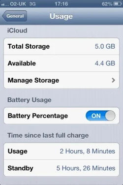

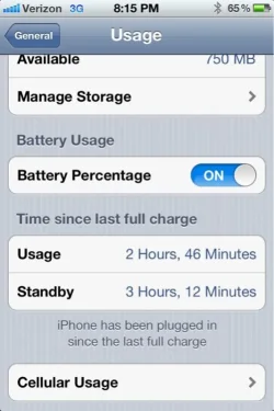

I am very close to a cell site (tower) and follow Zigs advise about deep cycling the battery
this is what I got last time I ran it down
