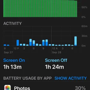

Here's my latest battery usage. $IMG_6600.webp Very pleased so far with battery life on my 4s with the way I use my phone.
