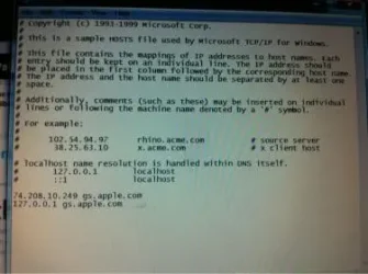

STEP #4:IF you have host.umbrella delete it
STEP #5:edit your host file it should look like this
NOTE: At this point I'm assuming you guys already have your custom firmware
