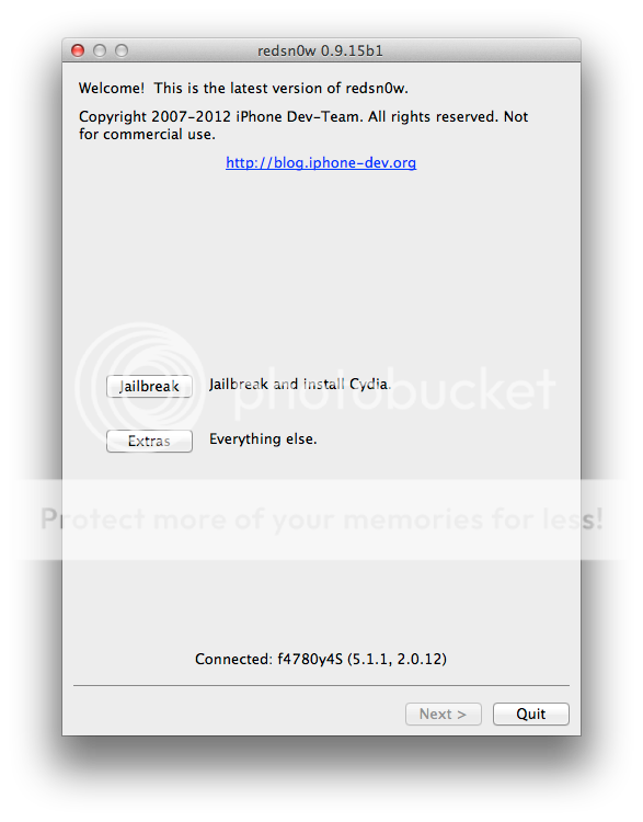

1. Connect your iPhone to your PC and shut down iTunes, if it automatically launches.

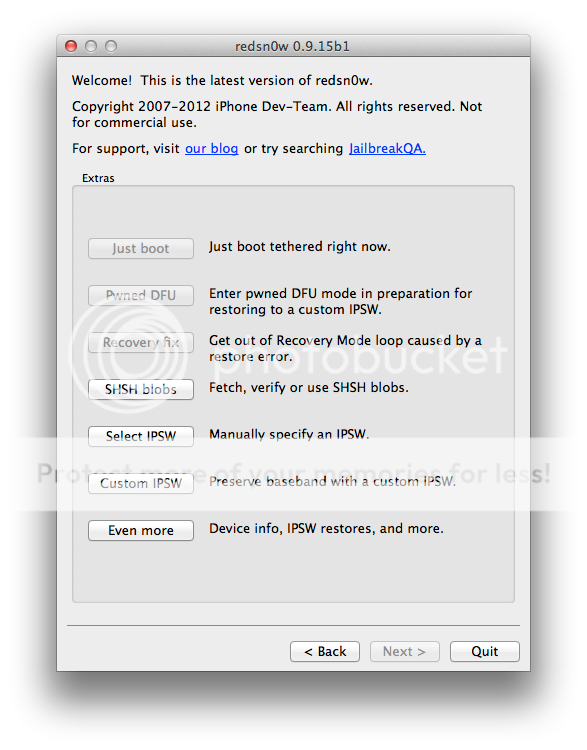

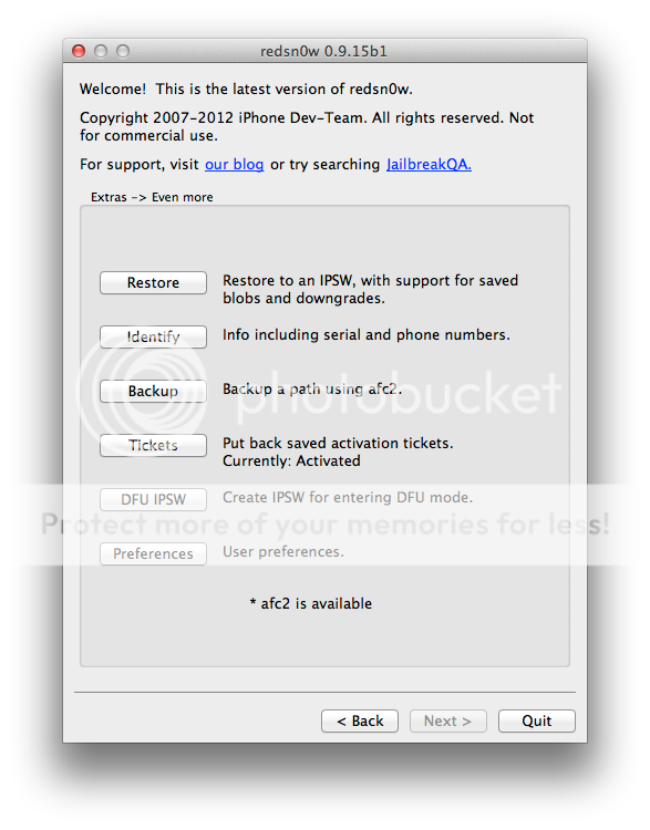

2. Launch redsn0w on your computer and select the "Extras" option (Don't forget to run the executable as an "Administrator" if you are using a Windows PC)
3. Press the "Even More" button

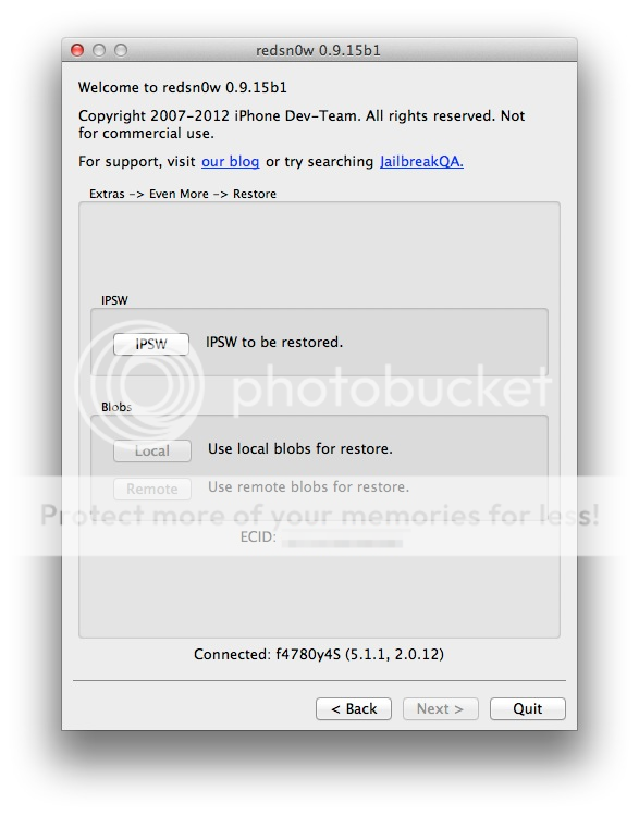

4. Press "Restore"

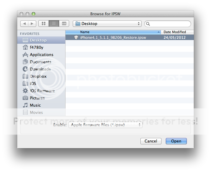

5. Press "IPSW"
6. Select the firmware file you with to re-restore, which you downloaded when preparing for this tutorial

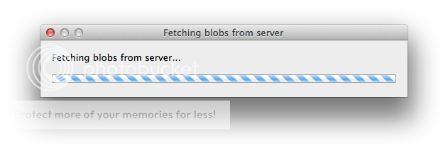

7. If redsn0w cannot find your blobs automatically, use the "Local" or "Remote" buttons help identify them)

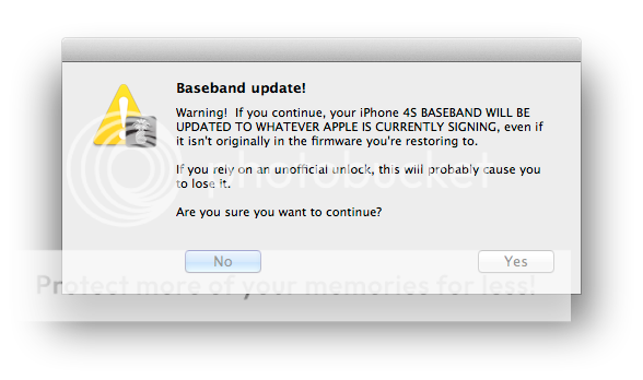

HEED THE WARNING ABOUT YOUR BASEBAND! Remember, don't do this if you rely on a software or hardware unlock solution unless you know you are safe to proceed!

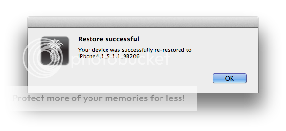

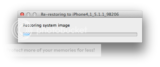

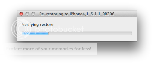

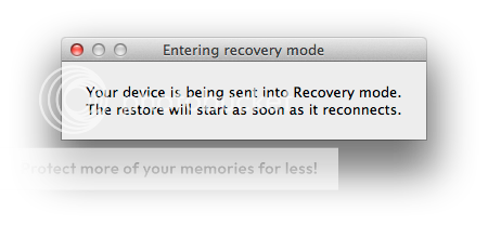

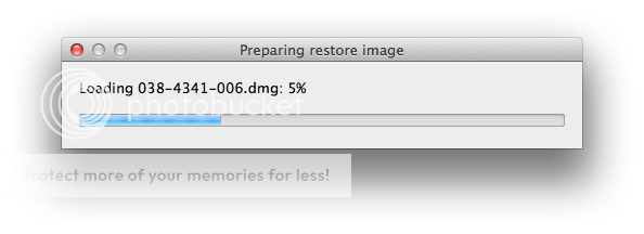

8. Marvel as redsn0w works it's magic
9. Congratulations! Your iPhone has now been re-restored to clean factory fresh IOS 5.1.1 (or whichever firmware you have chosen to re-restore with this method).

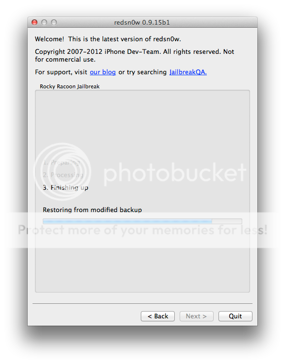

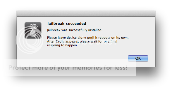

10. Once you complete the setup Wizard on your iPhone, go back to the main menu on redsn0w, and press "Jailbreak"
11. A few seconds later you will have a freshly restored device with a clean new jailbreak

WARNING - If you rely on a software or hardware unlock you must be very careful using this tool. The baseband will typically need to be updated on a non-A4 device. There is no way to preserve it. If you need an unlock, make sure you know what you are doing before you proceed! The phone used in this tutorial is factory unlocked and therefore immune from any problems!
